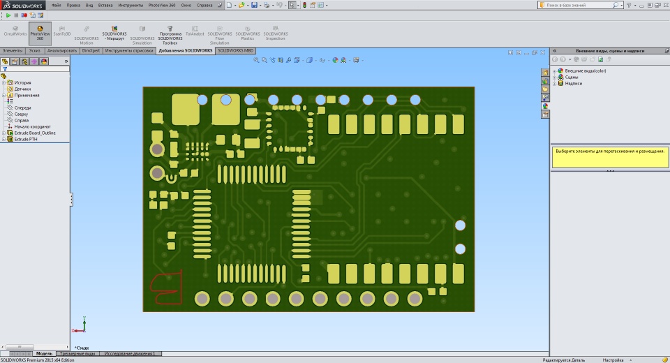

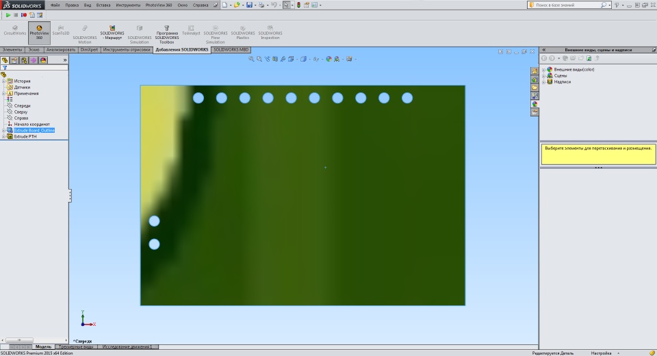

i make 2 decal (IDecal) for my model by example (2016 SOLIDWORKS API Help - Add Decal Example (C#) ).
First decal is normal and second decal is bad(very stretch).

Result:
where error?
