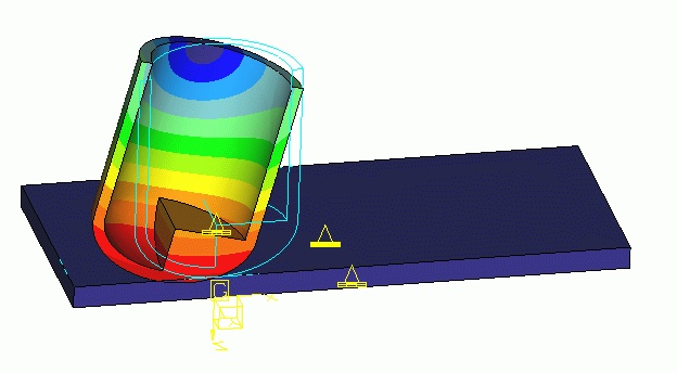

Hi,
I attached an assembly (sorry but it's in SW2010 PR1), where an object in PP material is supported on a steel plate.
I add the gravity and the Contact.
In the Basic Motion the object penetrates, but doesn't fall.
In the Motion Analysis the object falls.
Where do I wrong ?
I haven't still build the object, so I can't say if fall or not, but seeing the center of mass, I don't think it can fall.
Thank you,
Alessandro

Hi Alessandro,
This is a good example of the difference between accurate physics and approximated physics.
You can improve the settings for basic motion under the Motion Study Properties. Make the geometry as accurate as possible and the contact resolution as high as possible. However, I was still not able to get the cup to fall over due to the mass offset from the center. This is what I would call a limitation of the solver based on what I've seen. You will notice that when the geometry representation is low, it actually rests at an angle on the facetted representation, but still doesn't quite fall over. If you adjust the geometry slider, there may be one setting in there that may cause it to fall over, but it's hit and miss.
With the motion analysis engine, it is accurately calculating CM position relative to contact patch location and providing the expected/correct solution. Just be aware that this solver also has an approximated contact which while very fast, does not give 100% geometry representation. If you switch it to precise contact under the study properties, it will give the most accurate solution (but slow). You can also add friction in the motion analysis to improve the response so the part doesn't slide so much when it bounces. Contact parameters and solver settings can still play an important role in the response you get, and there are other threads where I've provided infomation on those

Hi Alessandro,
Pro/Mechanica only introduced 3D contact in Wildfire 5, so I do not know if it is just facetted contact or if it is indeed precise. Is the image you attached for Mechanica? If it is. what is up with the penetration?
For the ANSYS run, was the person using the rigid motion module in Workbench 11 or 12. I know they have a rigid body solver, but I do not know if they support precise contact with that solver. They can model the deformable body with contact, but realistically for something sitting on a table, the deformation is insignificant.
In both cases, you are talking about motion tools and in particular, 3-D contact models that are relatively new. I would be wary of the assumptions they may make. If any of them are using facetted contact, then the results are meaningless for this type of test. Only precise geometry can give the correct answer for a curved surface with a mass offset. in contrast, the ADAMS 3-D contact algorythim is very mature and I have worked with it since it was developed (I spent a lot of time testing it around 1999/2000). In the same way people consider NASTRAN and ANSYS the benchmark of the industry with respect to FEA, ADAMS is the benchmark when it comes to motion simulation.
As far as the model goes, you have a point of contact in essence, a mass offset from that point of contact. The outcome is going to be driven by the rotational inertia developed by the time the center of mass lines is directly above the point of contact (if it ever does get there). From when I review the motion, it appears there is sufficient momentum to cause the part to fall over.
Now there is a caveat when dealing with rigid body motion, and that is that we're representing part contact through a localized spring/damper force, but for your model it should be more than adequate. The other factor with simulation is that contact forces only arise if parts penetrate, and so the software applies reaction forces to prevent excessive penetration based on some characteristics that represent the materials and the parts that are interacting.
The default material and contact parameters are a good starting point, but they are just that, a starting point. Real properties depend on part mass, stiffness, roughness, material damping, and so on. This becomes more critical with parts that collide at higher speeds and have significant sliding. For rolling contact like in your case, the properties other that spring stiffness and damping are not big factors.
You can experiment with adjust the maximum time step or accuracy values, but i don't think you need to worry too much for the portion of the motion you are interested in (ie is it going to tip or not).
For the animations attached, I used a contact stiffness of 50,000 N/mm, exponent 1.5, Max Damping 1000 N/(mm/s), Penetration 0.5mm
