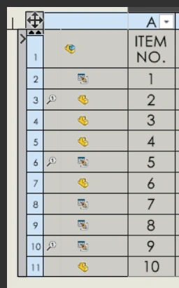

Some strange icons are showing in a BOM table that I have never seen before. Does anyone know what the table/spreadsheet looking icons mean?
row 2 is letting you know it is a weldment.
row 3 has a balloon on the item in the drawing and is a part.
if you hover the mouse over those weldment and part icons you get a preview of what the part is.
