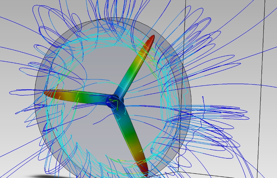

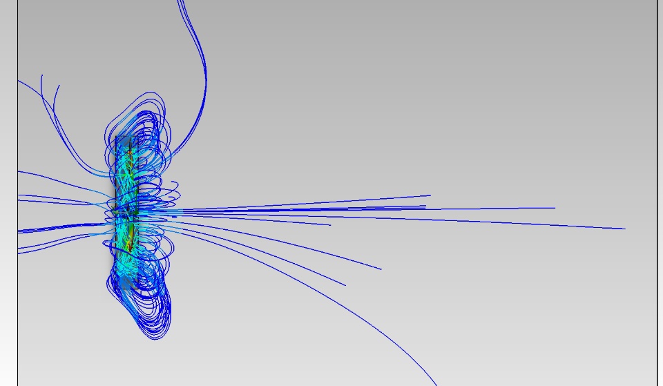

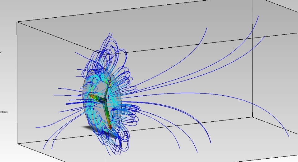

I have been trying to simulate air flow over an aircraft propeller at a given RPM but I'm not getting good results. When I simulate flow trajectories it I get a strange pattern, especially around the tips of the blades and behind the propeller, it doesn't "seem right" I do not know what is causing this, any ideas? I have extruded a cylinder that is used to simulate a rotating volume of air rotating at a given RPM, this way the blades are fixed. I also made sure to set it up as external and not internal flow. What could be wrong? The surface map is reflecting the velocity at that given span distance.
SolidworksFlow Simulation

have you tried increasing the size of your domain?  you're getting flow wrapping around from the backside to the front again.
What does it look like if you take a simple velocity cut parallel to the axis of rotation?

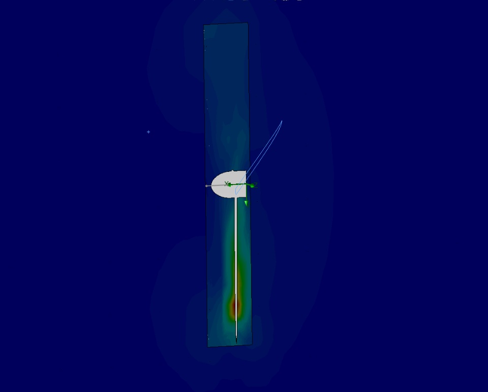

I realized there was a problem when I noticed that strange flow warping around, so I did as you did and nothing, still the same problem. I have made the domain very large, didn't affect it at all. I then inserted a cut plot (velocity) and hid the model and flow trajectories so it would be easier to see.

create a plot of the velocity in the axial direction (whichever axis that is x,y, or z) so I can see where the flow comes from and goes to.  The plot you put up seems to be speed without regard for direction.
What did you choose as your starting point for the flow trajectories?  I would use a plane perpendicular to the axis of rotation a distance in front of the blades so you can see air pass through the blades.
Do you work in Flow often?  have you gone through the rotating reference frame tutorials?
