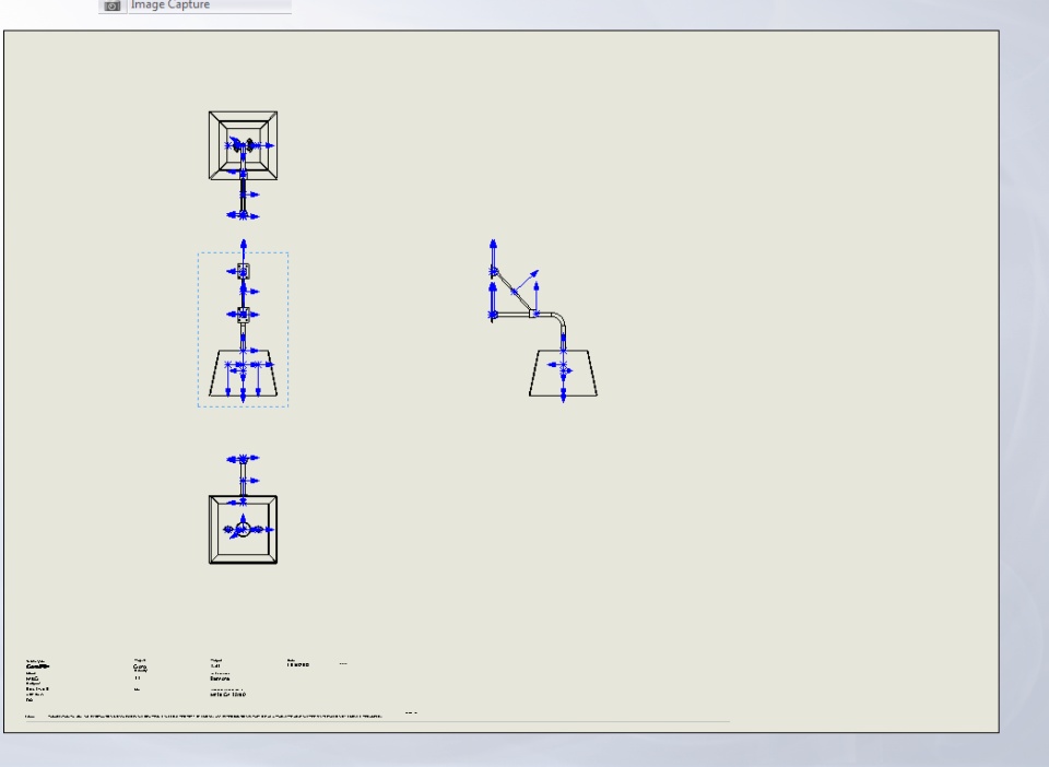

Strange blue markings on views in drawings
Started with a blank sheet and drawing templete, eveything works great adding sheets,and note populate. Now tring to ad views and this appears. any thoughts of leads on hot to correctly add views to blank sheet

Hi, Kurt:
Those are cordinates and origins of part models.  I can control their visibilities thru. view/hide commands.
Best regards,
Alex

Kurt,
You could also click on the "glasses" icon and click on the view origins.

SF 2013-11-19
View menu, uncheck Temporary Axes.  Happens to me far too often.
