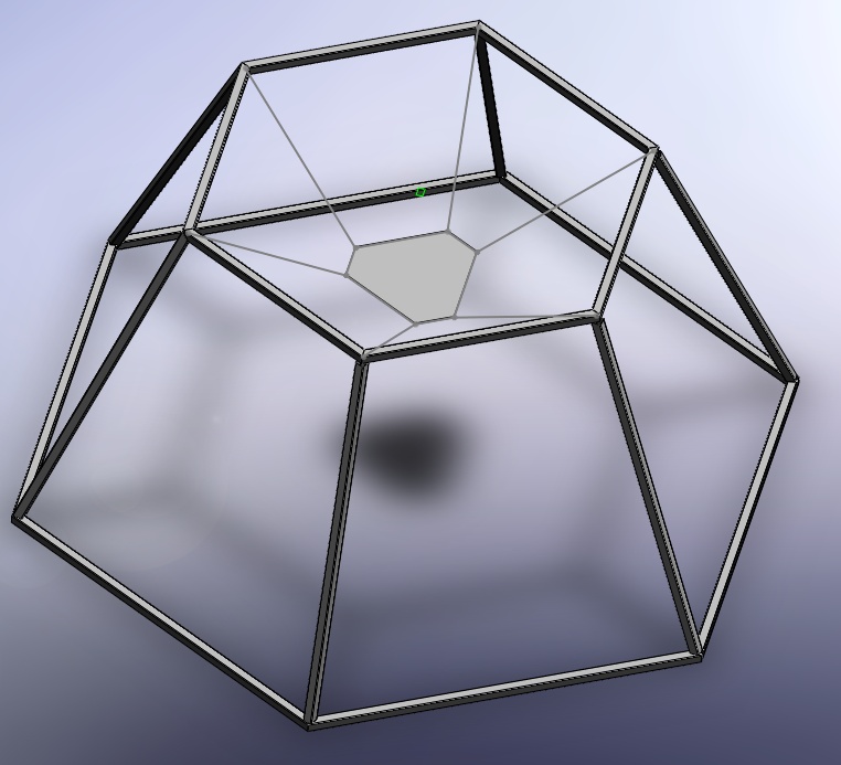

I'm designing an inverted cable driven stewart platform and wondering if any one has experience modeling this sort of thing and analyzing it in SW?
My first pass was a 3D sketch with weldment profiles for the structure and cable.  It works well with simulation as far as I can get it to spit out axial forces (tension) in the cables, but it is very difficult to change cable lengths.  Even with a design table I easily wind up with kinematic inversions.  Also it is easily possible to show compression in the cables, which in reality would be impossible.

Simulation does not have a cable (traction only) element. You see compression because you are, in fact, using a beam or truss element.

Thanks for the reply Daniel.  I appreciate you taking your time help.
Yes I am fully aware SW does not have a cable option (I called my local  tech support to ask about this first before posting) and that the truss is in  compression.  What I am really looking for is work  arounds, useful tricks, best practices that perhap other users have found while  working with stewart platforms.
I chose a 3D sketch with weldments linked to a excel table mostly because the simulation would run fast and it is very easy to modify.  I could also use this 3D sketch later as a skelton part for a final assembly.  I am curious to here other users experiences with stewart platform designs and how they approached the problem.

I did not read the whole series of posts but you could use the tension only springs to do this I would think. Under connectors -> springs and then select the appropriate options. Just put the stiffness of the spring to match the cable stiffness.
