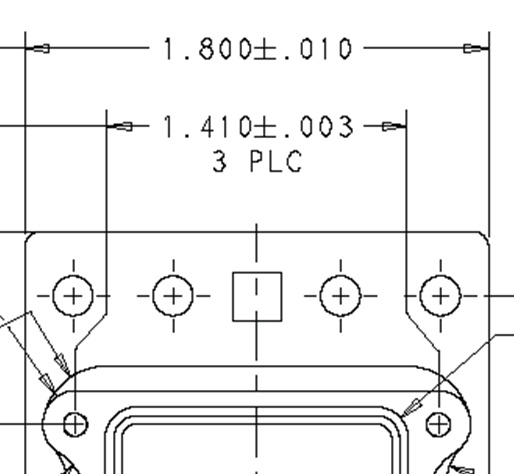

Is it possible to taper or step the extension lines on a linear dimension in SW? See the image below for what I'm trying to acheive & why!

Ross,
If you RMC on the extension lines, go to display options, then jog.
Frank

Hi Frank,
That's great, thank you. I'm not quite sure how I missed it, but your help is much appreciated.
