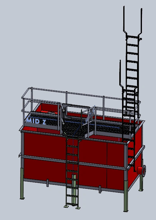

Hello All,

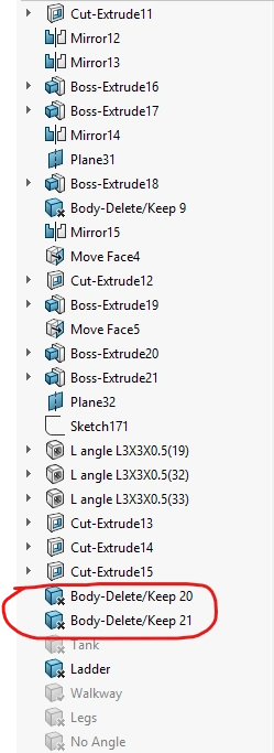

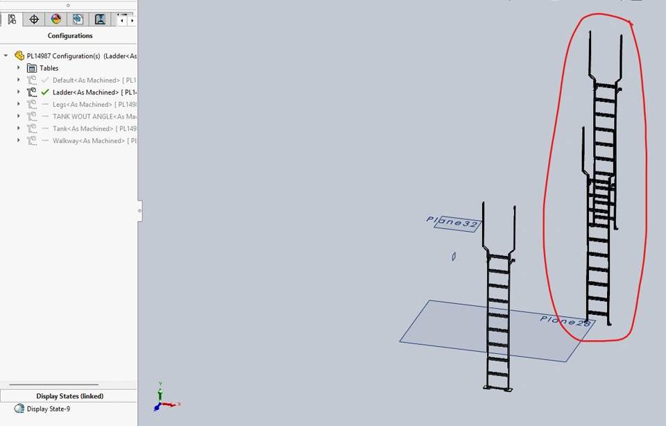

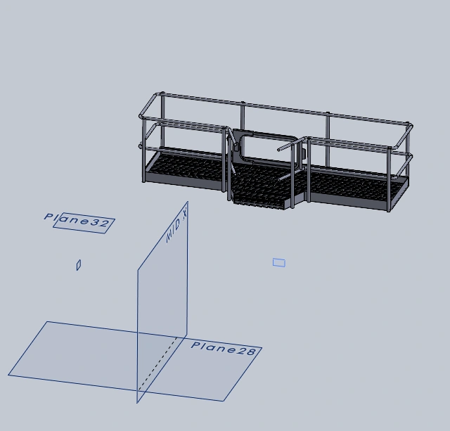

This is a super perplexing issue for me. I've got a weldment that we built off a scan. Inside of that, there are a couple McMaster-Carr parts we brought in. One of these is a stainless ladder. It just decided to multiply itself several times, so I did a delete bodies to try getting rid of it. Every time I close and open solidworks, it just keeps coming back. There are a couple configurations on this file, and it does this for everyone of them, but one. I just want to figure out why this ladder keeps re-populating itself, and to keep it gone.
I can upload the files to see if it does the same for anyone else, I also wanted to ask what would be the easiest way on this forum. They're giant files, and even zipped, they were too big to upload. Thank you!

What would happen if you deleted the extra bodies out and then save it as a new step or parasolids file and just pick the bodies that you would need. Then open that new parasolids or step file and see if that gets rid of the ghost bodies
