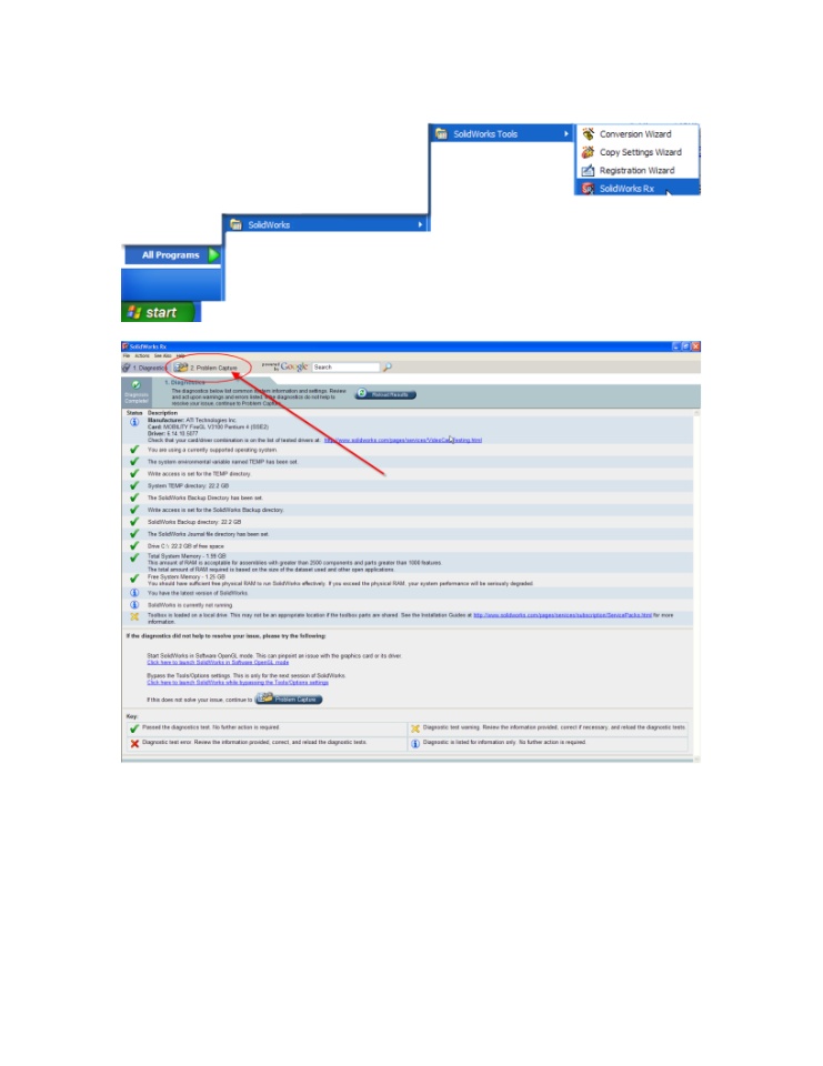

The Rx doesn't apear to show any issues, unless I'm missing something.
Converting a 170mb file to step may take a long time, I've never tried to convert a file that large.  I would open the step file and confirm on your system, maybe the import into Pro-E is the problem?

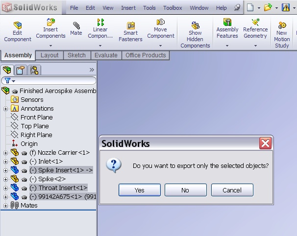

you select the part in the tree and save-as and it will ask you what you want.
SF
SF 2009-08-19
Thanks Lenny.  But sorry, I guess I'm missing something...I don't know how you got to the dialog box in your image.  When I select the parts in the tree and go to save as, I don't get anything different than usual - it's about the 'save as' the assembly.  I do know you can derive component part.  Is this the same thing?
LB
LB 2009-08-19
you have to one of the following...iges, step, parasolid to get the message. also must finish by saying ok, before it'll pop up.
