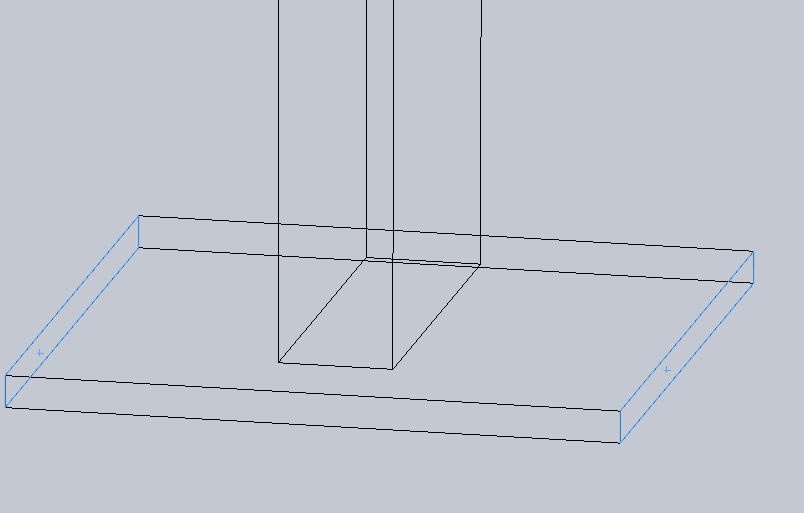

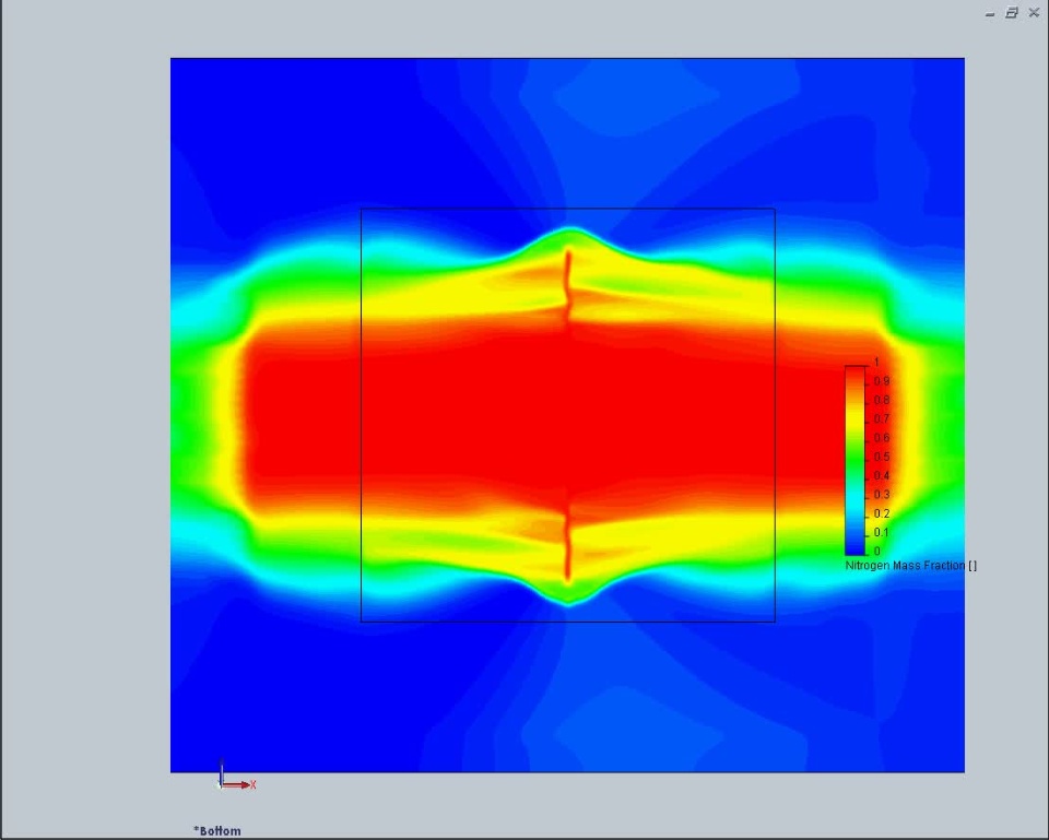

This is a simulation of a gas exiting a slot and impining a plate - colors represent concentrations of various gases on the impinged surface.
In the attached, I have a video.  Frame 1 shows the result of a steady state simulation that was taken as the starting point (0seconds) of a time dependent simulation.  The entire video represents a time dependent 10 second simulation.  This suggests that my "steady state" may have been steady as far as the overall model (95% unshown in these images), but obviously not stabilized for this region.  This 10 seconds took about 2200 iterations.  And as it stabilizes about 2 seconds in I would expect under 1000 iterations to stabilize.

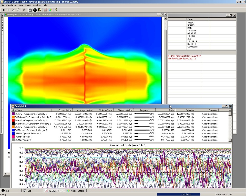

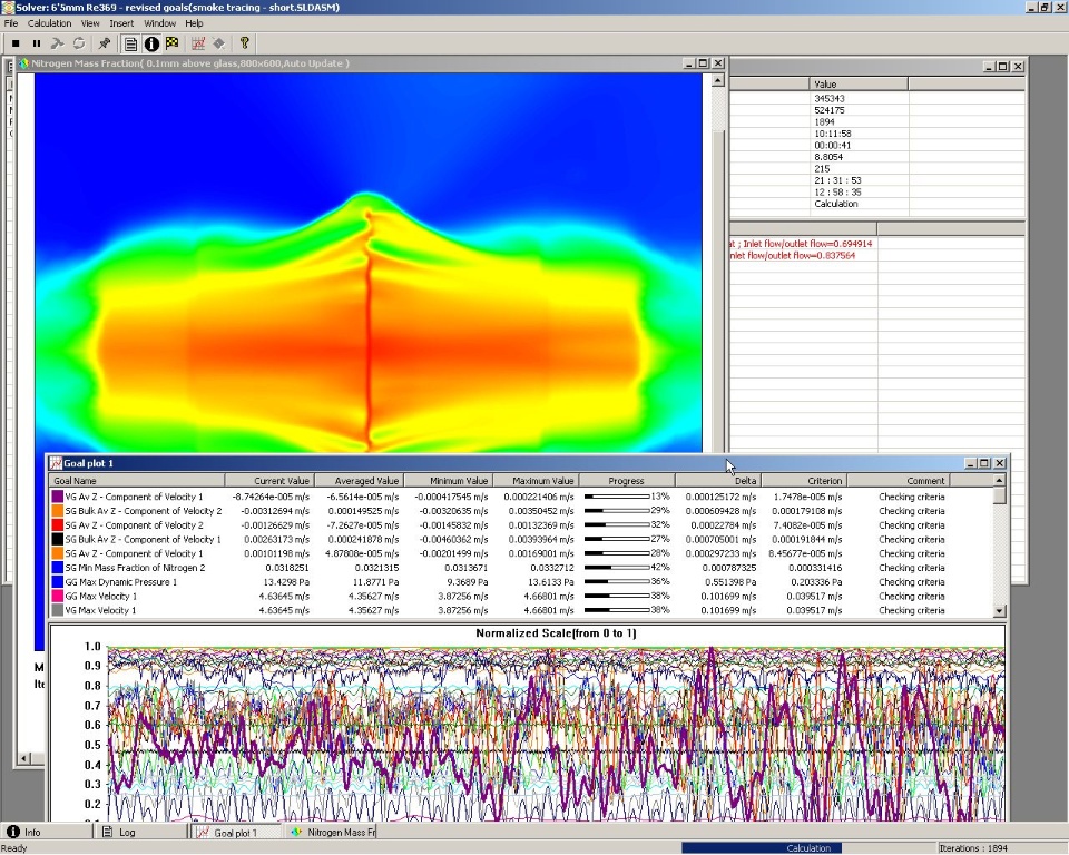

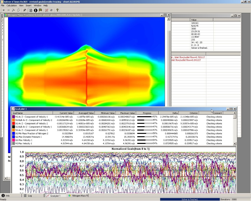

Based on this, I added more goals locally to ensure this was accounted for in my steady state simulation.  I have captured screen shots of the steady state along the way recently.  There are oscillations at the ends of the slot which result in the wild goal graphs (as the data shows, the oscillations are in mm/sec).
