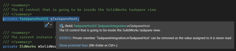

When hovering over the private TaskpaneHostUI mTaskpaneHost; variable, Visual Studio displays this:
