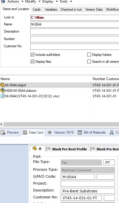

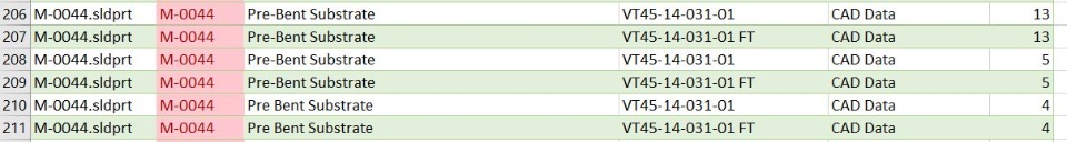

I'm trying to get the data from EPDM into Excel via Query 1 (see below). It works (in a way) but for some reason it extracts duplicates values despite I'm using MAXVARS.

There are no duplicate file names in the system.
Query result:
When I've tried to add the LATEST version but it went from bad to worse:
I just can't understand why is it doing it, and more important how to fix it.
The end result I want to see is just ONE line with data extracted from "@" configuration.
