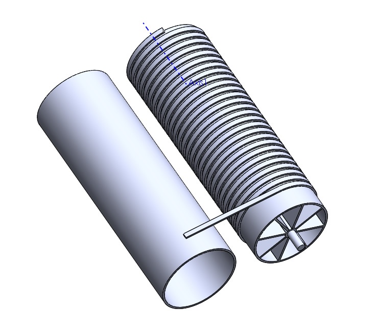

I am new to the forums and new to solidworks although I have been trying to pratice often.
I have a design idea that I am trying to simulate.
Basically it is a variable inductor that is created by two barrels with a 1/4" wide strap anchored on one end to one of the barrels and anchored on the other end to the other barrel.
The strap is wrapped around one barrel as a start point with it spanning over to the anchorer point of the other barrel.
For discussion purpose:
Barrel A is made from insolated material and Barrel B is metal.
As the strap un wraps from barrel A it wraps around barrel B.
The inductor value now get smaller and smaller as it wraps the strap from A to B barrel.
I do not want someone to just give me a working file although seeing a simulation and a explanation on how it was done would get me started.
Any suggestions on how to do this?
Thanks all
I attached a Picture as example

I need to know how to show the barrel turning and the strap un-wrapping from one barrel onto the other barrel and back again.

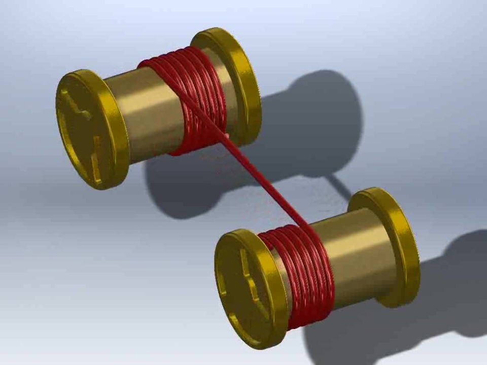

Jeffrey,
Attached is an example I found in this forum.

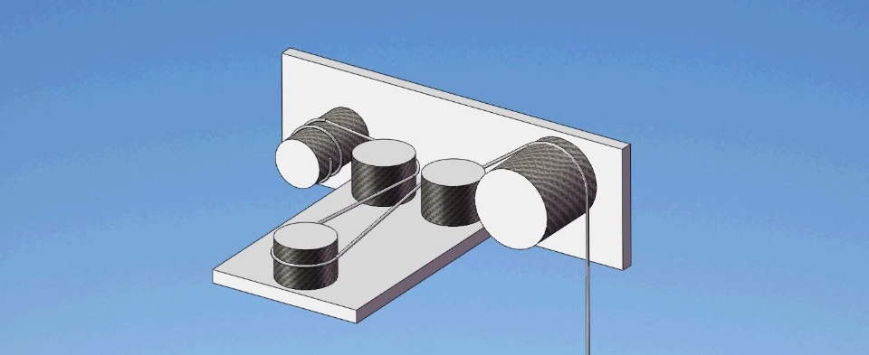

FM 2013-12-06
Jeffery,
Attached is the example I was speaking about.

Yes the cable on off is exactly what effect I am trying to get. now the question is how did he do it or at least a ideas that I can follow.
Was that a recorded simulation or animation?
But yes that is what I am doing except using a flat strap in place of the wire.
Thanks
SF
SF 2013-12-06
these are all animation. search for his name on the forum. i think he had a spot in the motion forum where he posted the files or a description. a google search might help you find a youtube video of how to do it.
FM
FM 2013-12-06
Jeffrey,
The steps on how it was done was on the Solid Professor website.

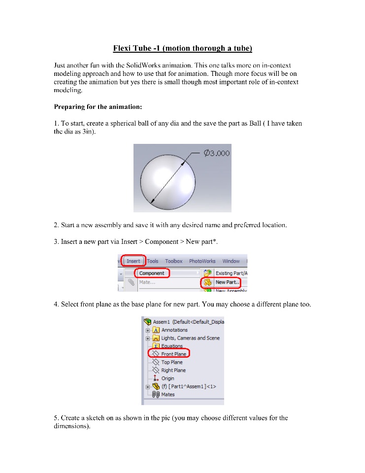

FM
FM 2013-12-06
Attached is a tutorial on how to animate a ball moving through a tube. Thanks to Deepak Gupta for sharing.
