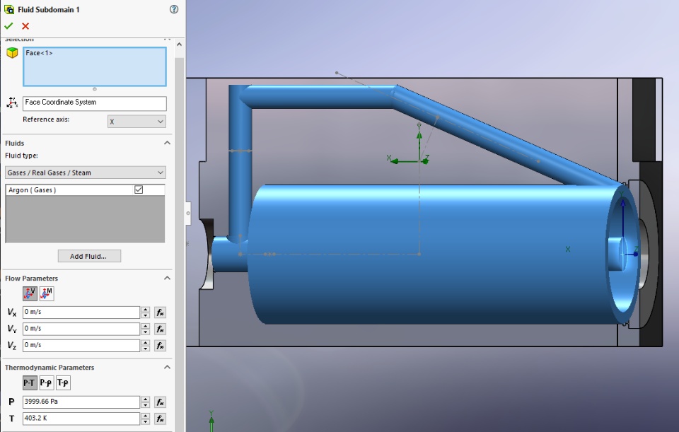

I am trying to run a flow simulation on a part that has a single flow inlet and outlet, but diverges flow through an orifice and a bypass and recombines them downstream. I originally had some good results a few weeks ago with this simulation but something must have happened where now I am getting unrealistic solutions. Here's the geometry being tested:
The annotations are for Volumetric flow rate at the inlet, outlet, orifice, and bypass. The boundary conditions are as follows:

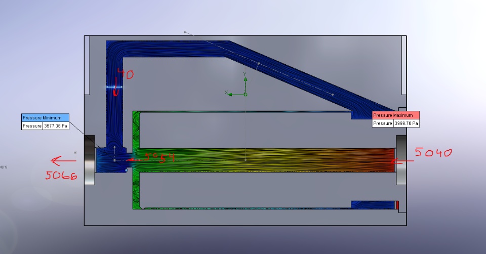

Problem/expected behavior:
When the simulation was working well (closely resembled experimental data) it had less flow through the orifice and more through the bypass, there was ~5x the pressure drop from point 1 to point 2, and the volume flow rates added up neatly (orifice + bypass = inlet = outlet).

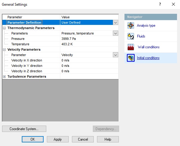

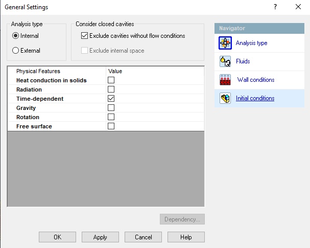

Other General/Fluid Settings:
SolidworksFlow Simulation
