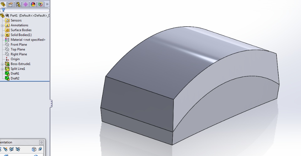

Hi Robert,
Split lines are useful for when you want to change the topology of the solid model.  Think of a block of material that I will eventually want to mold and lets say that the partline is not planar. From the side view, I create a sketch that defines the partline and then Iuse Split line to "imprint" an edge onto the block. Now I can use the Draft feature>partline option to add draft to the top side and bottom side of the block.  This is just one of many ways you can use it.

Question. I can do the same model you have in here by unchecking merge results?

Hi Robert,
In many cases yes, in many cases no. In the case that I presented no, because partline draft is a special type of draft which calculates the draft angle from the split line edge.
