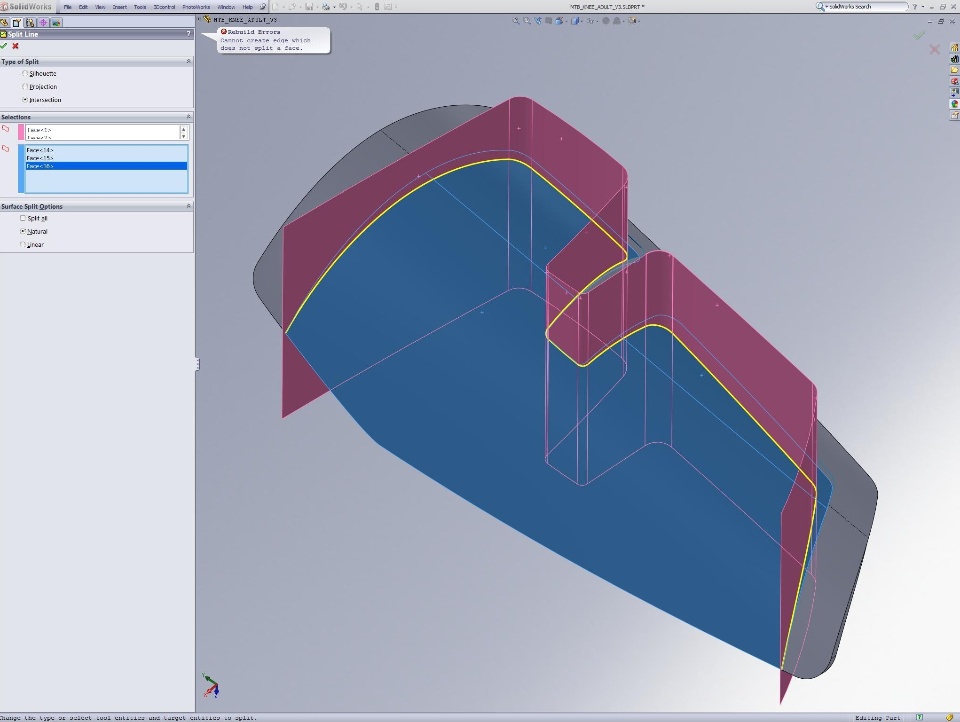

When I try to create a split line feature using a surfaceintersection, I get an error 99% of the time. Almost every time itsays, "cannot create an edge which does not split a face".Occasionally it says "trim tool and target are notintersecting....blah blah" even though they most definitely are.
I have to add 3-4 features to work around this every time, which isunacceptable. I use my workaround 4-5 times daily, at a minimum.
I had this problem about 25% of the time in 2008, and it has gottenworse since then. I cannot recall if this has ever worked in 2009.I am on 2009 sp 2.1.
What bugs the most is that one may clearly see that the surface isfully intersecting, but SW can't figure it out.
After some testing, I have narrowed this bug down to 1 case: whenboth the tool and target surfaces have more than one face, splitfails every time. If either tool or target is a single face body,the split will work. Otherwise, one must select one face on thetarget body per split feature, which is cumbersome and inefficient.Since very few of my surfaces have only one face, this bug bites meevery time I need a surface split.
I attached some images for this, as well as a sample part file withsome arbitrary surfaces. Try to split the multi-face pair, and tellme what happens!SolidworksSurfacing

I'm gonna guess that your results will improve if you select bodiesrather than faces. I can understand the face thing failing, becauseif you're selecting faces, SW doesn't know it's all one thingnecessarily, and the split line has to be continuous.
I can't duplicate your error, but I do get an error if I don't havefaces selected properly.
Just try to select bodies from the Surface Bodies folder at the topof the tree rather than selecting faces from the graphics window,or using the Filter Surface Bodies selection filter option. I'mguessing that this will work better and mean fewer picks to make itwork.

Matt's absolutely correct; make the selections using the Surfacebody folder so that you capture the entire surface body definition.Otherwise when using sketches (projection mode) its perfectly fineto pick from the screen.

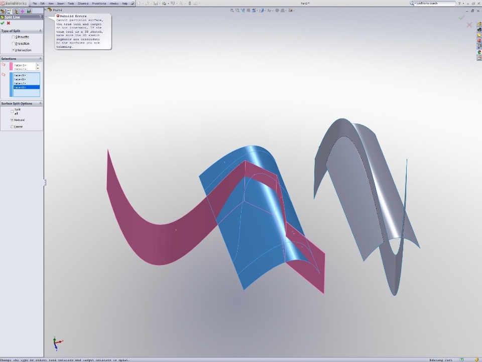

Interesting. My examples do not reproduce the error if I selectbodies or any combination of bodies and faces. I will report if Ihave this issue with selecting bodies, as that is my preferredselection method whenever possible, yet I have run into this issuemany times. Your tips should save me some time; thank you!

I have found one example where the splitting entity isselected as a body, but the faces/bodies to split are selected asfaces, and the split line fails, returning "cannot create an edgewhich does not split a face"
In this example, I would only have to copy the face, split it, andreplace the original with the split faces. Not much, but still morework than I want to do for a simple split line.

Another example of a split line with a simple, single-facecylinder selected as a body for the trim tool and multiple faces tosplit. It fails.

The red body is tangent at the intersecting edge and as suchextending does not help. I should have stated that when I postedthe image.
Trim fails in this case due to geo. conditions, verification on. Ihave used surface bodies with the same results (or lack thereof).Again, I should have stated that when I posted the image.Alternatively, you could have pointed out my omission asked formore information.

The example you show won't work because of the tolerance betweenthe edge of the surface body and the edge (or split line) on yoursolid body. You need to avoid these situations in SW because one isNon-manifold (open surface) and the other is manifold (closed body)and SW has a hard time distinguishing which side the resultantmaterial (Boolean) ends up on. Of course in the perfect CAD system,this shouldn't occur but this phenomen occurs in almost every otherCAD system to some degree depending on the absolute or relativetolerance of the part/system.. Why not make it a very hightolerance you might ask - if we did then that would take more ormuch more time to compute the result (the mathematicians call itparameterizing the boundary or edge) so we try to find a gooddefault tolerance to keep the performance up.
The classic case of this problem is when you create a sweptrectangular body along a somewhat swoopy spline. Then create asplit line on the top face of the swoopy rectilinear shape. Now usethat split line as the sweep path of a new surface who's profile isa simple 3 point spline - now try to cut away the rectilinear shapewith the newly created surface - it might work, it might not. If itdoes work, inspect the edge that used to be the split line. You'llprobably find that it is a "dirty edge" meaning that there are manysegments that are the original split line and then many other edgesthat are a result of the surface cut. They don't exactly coincidebecause of the tolerance of the sweep surface command and theoverall default tolerance of SW. I've attached a part as an exampleof how to use our heal edges command to clean up these dirty edges.
So In the image that you show where the red surface body isintersecting the blue solid part, just don't include the top faceof the solid and you'll be okay - that edge coinciding with thesurface body edge is probably why your split is failing.

I'm not sure what to do with the file you posted. I used thesupressed surface sweep to cut the solid, and indeed it generates abroken up "dirty" edge. When I try to heal these, SW says that theface has no edges that can be healed. Is that the point?
I should say that dirty edges are what motivated me to use a lessthan optimal split feature in this instance. All other methods Iknow about failed with verified rebuild on, and generated seriouslydirty edges with it off. I checked for invalid geometry, but therewas none to report. I used heal edges, but it altered the edge toomuch and the result was unnaceptable. What is worse, both thehealed edge and the unhealed dirty edge got even more jagged andeven partially lost tangency between its faces once mirrored!
Regarding the heal edge tool, I usually end up trying it, seeingwhat it does, and deleting it because it is too heavy handed andadjustments often do nothing. What I mean by that is that once Iclick on "heal edges", if I want to change a tolerance, I usuallyhave to rebuild and re-edit the feature, or build a new oneentirely. This makes it very hard to dial out the heavy edgehealing and simply "merge" tangent edges the way it would in aperfect world. An example of this is a 2-edge projected circularhole in an arbitrary surface. I have seen heal edges delete thehole, but usually it just goes way out of round. Sure, I can backoff my settings, but the featre doesn't update so well. I shouldadd that this is most common with imported geometry, but alsoappears with native geometry. To be fair though, heal edges hassaved me a few times and is always an option I at least try to use.
The top face of the solid body is already split at the intersectionof the red and blue bodies on the top face. I do not need to splitthat face. I tried selections of solid and surfaces, surfaces only,surfaces with surface faces, surfaces with solid faces, surfacefaces only, solid faces only (after thickening the split tool); Ieven copied the faces to split as an isolated body. I'm notsurprised that the final image I posted failed, but one of my otheroptions should have worked.
