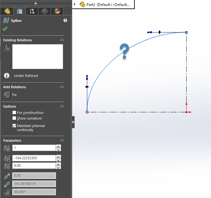

Is there any way to control the length of the spline? I mean if want a desired length of a spline whether it is possible to have it.

..just dimension it... (image)

Here is another way:
However, you have to make sure that your spline length is never shorter than your farthest control point.
