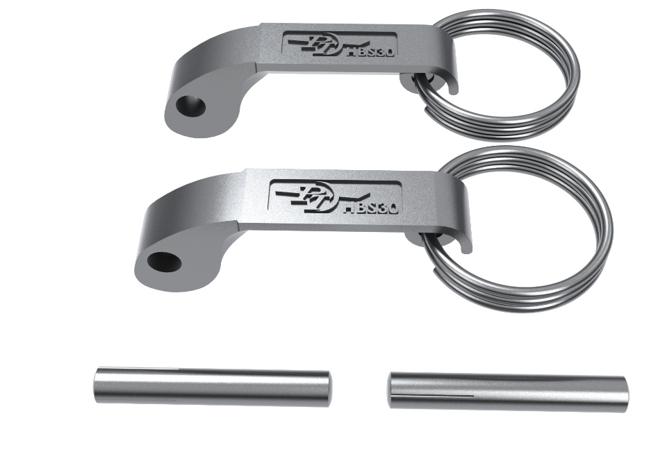

What are your current system specs? 5 to 6 minutes doesnt sounde exessive, but would need to see an image you have done to be sure. a lot of things will make a render take longer, i do a lot of images with glass in them, these will often take longer than 30min to complete at " best setting"

I'm note sure of my current system configuration, I will have to get with our IT department to get that information.  I am rendering simple models without the back ground to make it easier to put on a brochure, catalog, or poster.  I always do my rendering on the good setting.  I have attached an image that took 5 mins to render.
