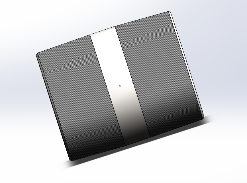

I apologize for the basic question, however I can't seem to find an answer anywhere. I'm using the Solidworks Routing feature to assemble some pipes. During this process, I use the built in parts when you access the Design Library > routing > piping > nipples > barrel nipple
When I insert the barrel nipple, I specify 1.25" sch 40, however it doesn't ask me how long I want the barrel nipple. This is what I get:

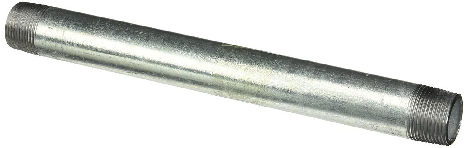

This is what I want:
Image result for 1.25" barrel nipple 6"

You can edit the dimension in the sketch after opening the toolbox component. Since it's a read only part, you have to "save as". It's not pretty, but it works well enough.

You need Microsoft Excel to edit DT for this part.

Edit your DT and a new one row with all the data

Thanks, I thought of doing that, but the dimensions are locked by a design table; however, I'm using the student edition, and I think that feature isn't supported. I was wondering whether there was a different method.
