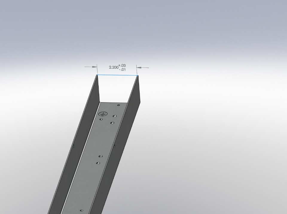

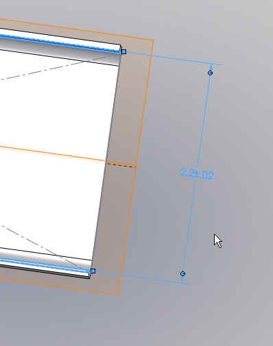

Does anyone here know how to create an edge flange where the distance of the distal edge of the flange is the driving dimension for the bend angle?  This is what I'm trying to do:
The only way I can (seemingly) specify the bend angle of the wall on the right is by angle relative to some planar surface.  but that is not the driving criterion for my design.

The first thing that comes to my mind is to start your base flange as an open sketch that has that dim in it.  That's an example where you put in just what is important to you and develop from there.

Or, just had another thought.  In the case that the part has already evolved to that point, then make that leg in question as a miter flange rather than an edge flange.  That way you can hold that dim with the flange sketch.

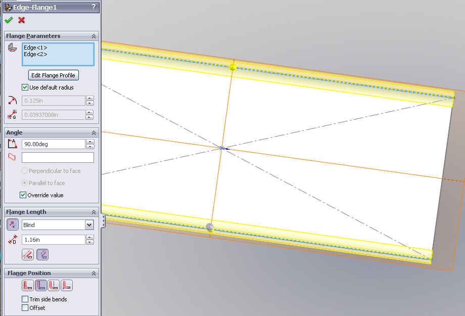

I can't quite tell from your pictures, but it still appears that you're specifying angle.
TC
TC 2010-10-06
The angle is there, but under Flange Position select the second box from the left. (Make your base flange the width you want)

This is an end view of a simplification of what I'm trying to do.  I'd like the distance dimension at the top to be controlling.  Right now the angle is controlling.  Any way to do this?

make that profile your base flange, as Wayne suggested.
otherwise you could set up an equation. with the desired opening dim as a global variable.

Ok, this appears to do the trick.

Yes, that's an option for some features, however, the geometry above is not actually what I'm trying to create.  It's many bends down the road from the base flange feature.

yes, it's no trick when it's geometry of the base flange.  Just can't do it afterward.  You can use the mitre flange option, but then you have to guess the offset for the wall from the line that you draw.  It's pretty time consuming to figure that out, but it does work to do that.
