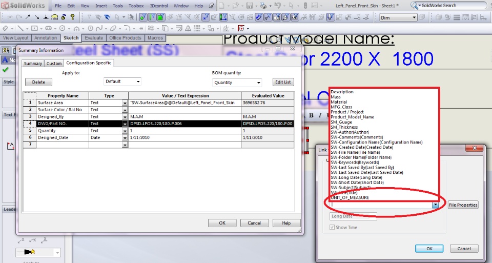

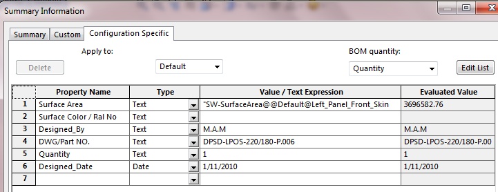

I have a part with different Configuration and every configuration has it's own part number, My problem is that I can't link Specific Custom Property to the Note in the title block. is there a solution for that.SolidworksDrawings And Detailing

Custom Properties will be same be every configuration though the configuration properties may varies with configuration. I believe you looking to link to configuration specific properties. Can you list out what issues you facing while doing so as I can do it very easily, just like you link your notes to custom property. Just make sure you have configuration properties defined and have a view in the drawing before linking them.

Look the Custom Property that I need to capture in not in the list as you see.

Make sure you selecting "Model in view specified in sheet properties" in Link to property dialogue box.

I believe I found the cause of this problem which is as follows:
the part that I was working on its Drawing is a sheet metal part. The first view I inserted in the Drawing was for the Flatten Configuration, and the custom property that I wanted to capture was for the default configuration. So as the Drawings In SolidWorks only sees the Custom Properties for the first view
I wasn't able to capture that Property in the Title Block Notes.
This is my analysis to the problem if anyone has any comment on that I'll be happy if we share it.
Thanks in Advance.
JF
JF2010-01-12
you can set which view solidworks pulls property info from. goto sheet properties (rmb sheet name and select properties
at the bottom will be a dropdown listing the drawing views. this change only afects the particular sheet you are working on.

The drawback to all of this is that you cannot pull custom prop values from more than one view at a time.

For title blocks, yes you are limited to one view. Notes on a page, however, do not suffer from that limitation.
