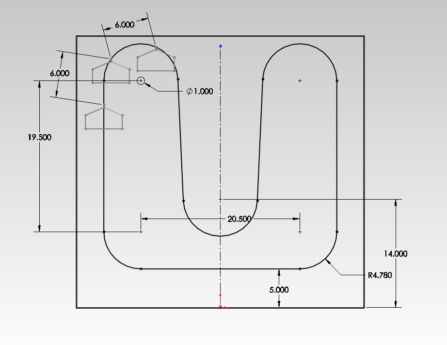

I've created a path in a sketch consisting of arcs and lines. I'm trying to visualize a chain with attachments every 6" on the chain. Is there an easy way to place entities or blocks on the path and specify that they remain x distance along the path from another? When I use a regular dimension between the two blocks then drag them along the path whenever the two start to go around an arc, the distance relation is the chord between them, not the arc length segment.
Is there a way to add the type of constraint I'm looking for?

I don't think there is a way to do what you want in a sketch. I can think of one possible workaround, if you can live with only being able to move your baskets less than the 6" spacing. Split your arcs and straight lines into individiual segments. Dimensions a straight section leading into an arc as less than 6" and then use an equation to drive arc length of the first section of the arc following the straight section as 6"-the dimension of the straight segment. Now dimension all of the other arc lengths and straight lengths to be 6" until you get to the end of the arc where you use a driven dimension that allows you to use an equation to drive the next straight segment.
It might actually be easier to solve this with bodies instead of a sketch. Make a body to represent your basket and use a Curve Driven Pattern to place copies around the path. I think that Curve Driven Patterns use the distance along the curve to establish the spacing.

Take a look at Insert>pattern/mirror>curve driven pattern
Also take a look at these threads
https://forum.solidworks.com/message/57542#57542
https://forum.solidworks.com/message/194242#194242
