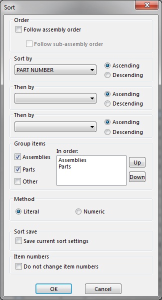

I have a macro, that i thought was correct... I want to sort my top level BOMs by "Part number", "ascending" in order of (1) assemblies then (2)parts...
The normal "Sort" GUI works, must be something i cant see...
