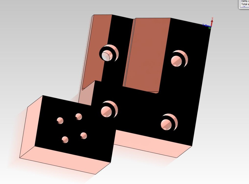

Is there a setting with in SW that you can move the lighting to a different direction? Or should I choose a different color for the material? It is difficult to see some of the features when normal to the blackened face.
SolidworksParts And Features
Turn off RealView, or select another scene, or rotate the model a little, or read the Help file on Lighting.
Turning off RealView does the trick for sure. Changing the scene is the second choice however depending on the rotation and having realview back on gives the same result. Rotating the Model defeats the purpose because sometime you want to be normal to a certain face. Just another sexy feature that SW has put in unnecessarily that creates issues in my opinion. So I guess the correct answer is to turn off RealView.
Mark, you can actually move or redefine the lights, as Kelvin said. And again, as he said, you might want to read the help section on lights for more information on the topic.
