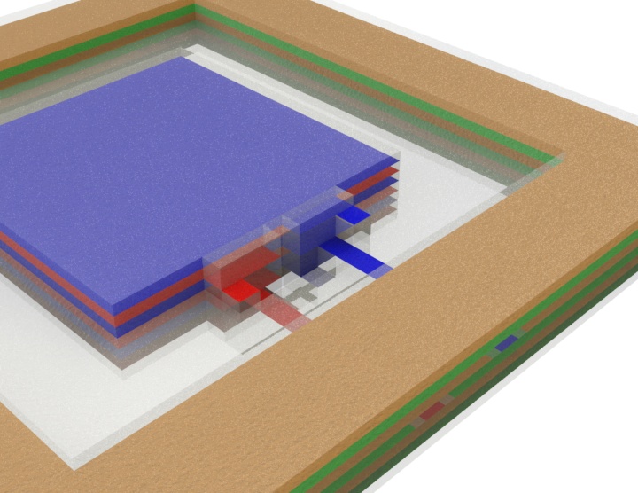

I am attempting to render some cross-sections of a layered structure using Photoview 360 in SolidWorks 2019, but cannot get some of my features to show up. The structure is mainly made up of 70% transparent matte rubber along with a few key faces which have opaque rubber appearances assigned to them. Because this structure is meant to be used as a visual aid describing a layer-by-layer fabrication process, I need to be able to take cross sections at defined faces to show certain features on each layer. This all looks great when examining the structure in the main graphics window, outside of Photoview. See the image below:

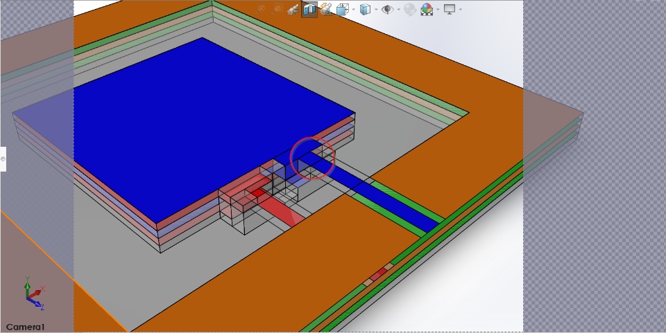

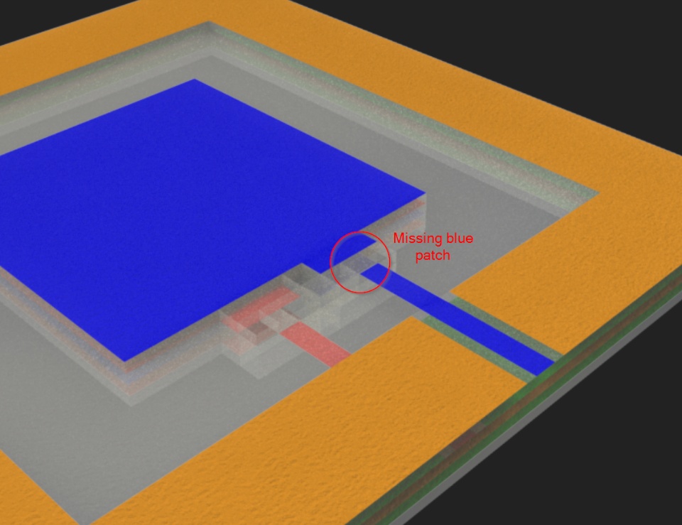

Once I use Photoview, however, either in the final render or in the preview window, surfaces on two of my stairstep-like bodies fail to show up. This only occurs in cross-section view; if I just do a render of them with blocking bodies manually hidden, it comes out alright. The first image shows a render in cross-section view with a patch missing. The second image shows a render taken from the same camera, but with cross-section turned off.
These stairstep-like bodies were created by a series of split operations, as were the layers in other regions of the part, but only the stairstep-like bodies exhibit this issue. They shouldn't be hollow, since they are split from a solid extruded block. The same problem appears on all three steps of each of the stairstep bodies.
