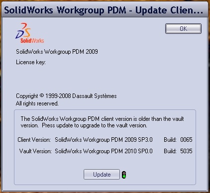

I've recently updated to Solidworks 2010 and PDMworks 2010 on the server. For some reason the Workgroup PDM Client (aka, the Admin tool) on my local machine is still 2009. I've tried several times to update this to 2010 but I cannot figure out the install procedure.
Any suggestions would be appreciated!

You must not have updated SW correctly.  Trying running the installation manager again and install PDMWorks again.

Hi Jesse,
Before I do that, I am going to see if the vault admin shortcut is pointing to the new application. It could very well be pointing to 2009 still.

did you install 2010 on ur client?
LD

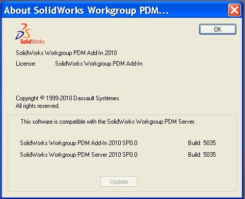

LD 2009-11-23
Yes, everything was installed properly (I think). It looks like the install did not like having PDMworks 2009 on the machine at the same time - I did a separate install instead of an upgrade. I solved the problem by uninstalling all the 2010 PDMworks stuff through the installation manager from Solidworks and then removed all of 2009 though add/remove applications in windows. I then reinstalled the 2010 PDMworks applications through the SW installation manager.  All is well again!
