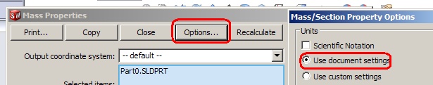

Make sure you have checked Use document settings in the Mass/Section Property Options

Document Settings is checked when I go to TOOLS/MASS PROPERTIES/OPTIONS.

Not sure I was clear in my previous response.  Yes the Use Documents Settings is checked, however the problem persists.
