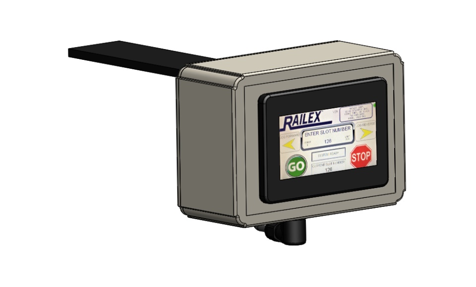

I did that but its not showing the decal.. Is there a way to show decals in AutoCAD? or would I have to trace the decal in solidoworks (not trying to do that!)

try to save as igs file and see if decal shows back up in solidworks then open in acad.

How is the decal created? Is it a sketch picture inserted on the surface of the box?
You might want to set it so the sketches show.

If that label is a decal, and I suspect it is, it wouldn't even show up in a SolidWorks drawing unless it was a shaded view, so I'm not surprised it isn't showing up when you save to AutoCAD. Have you tried creating a SW Drawing, with a shaded drawing view showing the decal, and then save that as .dwg? I still don't have high hopes, but it's worth trying.
