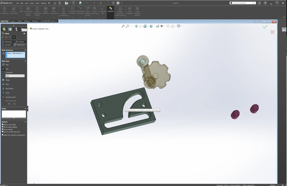

SolidWorks Slot: Current entity is not valid for current mate type.
There is no way I can mate any of the objects on the guide to its slot. It's impossible. I spent the whole day yesterday and this morning, and it is just impossible. I removed all the mates, floated, fixed the objects, and tried all kinds of combinations, all unsuccessfully. Why?? Is it because of fillets on the guide? I did experience many issues near the objects with fillets applied.

A slot mate will only work on a single slot, it will not work on a tee slot.  You can go with selecting a closed loop with a path mate, but that has a limitation.  See video.
JS
JS 2025-07-19
Another solution is a cam mate.  See video.

Failing on cam mate, with the same negative result.
PD
PD 2025-07-19
Failed on the path mate as well. I have two pins; as they both move from the bottom up, one should turn on the curved path (and within turn the hinge mechanism)... I am failing badly here.

Too simple.  There are two separate paths.  One pin takes the straight path, the other takes part of the straight path and the curved path.
