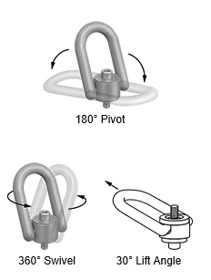

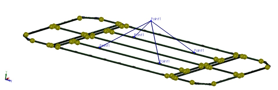

I have a rather large frame structure that is going to be hung from an overhead crane via a 4 point lift sling. The lift sling will be attached to the frame with hoist ring lifting eyes (which are free to rotate in 2 directions). An image of the frame (with representative sling) and hoist rings are shown below.

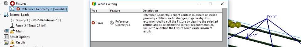

With that being said, how should I constrain this frame so that it deflects properly? The 4 hoist ring attachment points will translate and rotate slightly in the X, Y, and Z due to the deformation of this frame caused by gravity and external loads.  Originally I started to try and simulate the lift sling with 4 link connectors between the frame attachment points and a common centralized point. According to what I understand, the link connectors are defined between 2 points or vertexes and are hinged (free to rotate) at both ends. I was able to successfully define the link connectors but when I try to constrain the central point where all the link connectors originate from, I am unsuccessful. (See below)

you need a solid element at the central point and then you fix that geometry, Put a box with one vertices at the central point you want the link connectors to attach to and then fix the opposite face of the block and ignore the block results or make it rigid. Also you need solid elements at the other end as well. It will work well for what you are trying to do.
ME
ME 2017-11-06
Thanks ​. I was able to implement what you suggested and get it to work.
