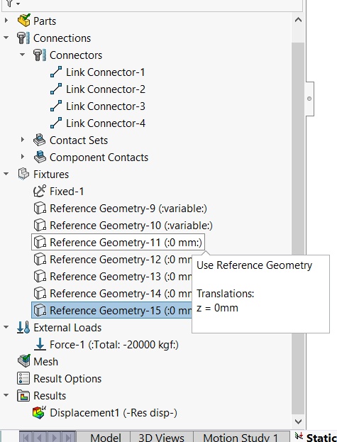

Hi All,
I am doing a simulation for a steel frame being lifted by slings. I have restrained the frame from moving in the horizontal axis (and vertically upward direction). But when running the simulation, I am only getting the displacement. Any advice why I am not getting the stresses? I have used 4 pins models inside the padeye holes and have made no penetration contacts.

Hi Lakhvinder,
Your images do not give us enough information to determine what the problem is or how to help you.  Are you able to attach the part/assembly files for this model to this post so we can look at the problem directly?

Hi Lakhvinder:
I can see the stress plot by right-clicking on the  Results node.
This is the Stress plot: It is very low.
