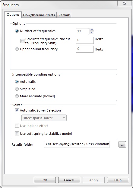

The number of frequencies entered in the properties was changed from the default 5 to 12 yet I am only seeing 5 mode shapes after I run the study. When I list the resonance frequencies, all 12 also show up.

The solver will calculate for the first 12 frequencies according to these settings.  However, a default frequency analysis only automatically generates mode shape plots for the first 5 natural frequencies.  You can change the default number of plots that are created under 'Simulation', 'Options', 'Default Options', 'Frequency/Buckling Study Results' in the setting for "Create plots for..." by setting it to "All mode shapes".
This impacts new studies.  For existing studies you would need to create the additional plots manually.

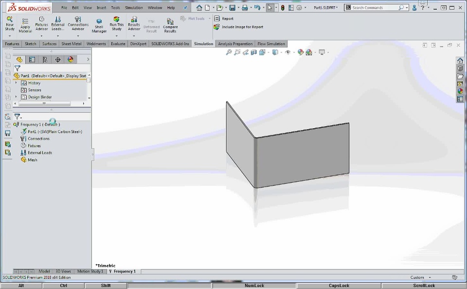

The only difference is that I am working on a second frequency study on the same part. The first study was able to produce all 12 mode shapes. I've found that left clicking Results and using "Compare Modes" helps me to show the hidden modes but once I exit this comparison the modes disappear.

RD 2018-03-06
If your second study is either a duplicate of the first or created then specified to be 12 modes instead of 5 then it should have all the mode plots too.
EDIT: My colleague pointed out this SOLIDWORKS Knowledge Base article that may help explain some of this:
S-041284
Issue: The "default" plots are only created when a NEW study is created/solved. Changes in the default options are not applied to existing studies, even if they are solved again.
Explanation: Also, in the "Frequency/Buckling Study Results" option, be sure to enable the "Results type: Amplitude" checkbox. Otherwise, the "Create plots for all mode shapes" option will not be implemented.

once you run a study for given number of mode plots changing the number in that study will not generate new plots automatically. It only works the first time in a study, after that you need to make a new study and use drag and drop. Duplicating doesn't help. You can always add plots to a study to plot the new shapes if you increased the number. I have to admit I did not read the above to carefully so excuse me if I missed the whole point here.

Seems my system may have a funny bug as I was not able to successfully implement any of the suggestions. I've gotten around this issue by re-running the conditions for my second analysis over the first study. Thank you all for your help.
Ni
SF
SF 2018-03-12
Copy study and re run
