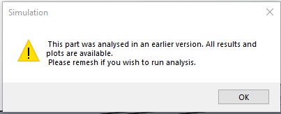

First I got this message:
Followed by a crash.

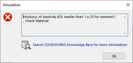

Reboot, restart and the next error message is this:
Hitting "Run this study" again and it solves with no issues.

Might have something to do with your material library.
