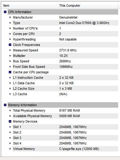

Given the prior discussions about the benchmark scores, some of which didn't seem to line up, I took a little closer look at the "detailed" data.  Here are seveal points that I noticed:
  1. The OS is always listed as x86 even when SW is listed as x64, which is not a valid combination.
  2. The processor speed, which is obviously a critical component, is not always captured.  For example, see gTest1, DGraham_HP9400, purCAB1.  They list the model, family, and stepping, but this is not necessarily unique to a specific processor frequency. Additionally reporting the info just from the CPUID will not properly reflect any overclocked machines.  I have attached the partial output from PassMark for reference.
