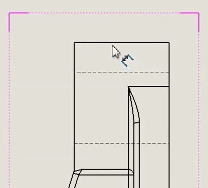

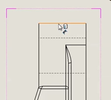

I have a problem with Drawings. I don't get orange mark in the line which I'm trying to snap. Like in the image below. My screen looks more like the one below. No orange, even if cursor is pointing the line. What to do?
