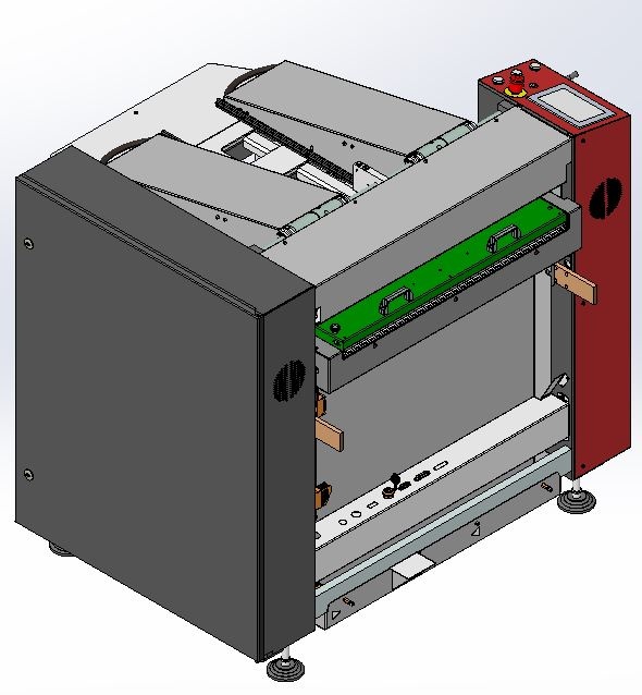

We get quite a few step files that get converted and saved as a part file such as this;
The issue is we end up with feature trees that look like this;
I was wondering if it would speed up the time to open this if;
  1. when being converted it it were to be converted to an assembly where all bodies would be a piece part
  2. use the combine feature to combine as many solid bodies together minimizing the amount of solid bodies
I tend to work remotely some times so i use a laptop, it works fine for the majority of work i do but when it comes to files like this the laptop struggles so i am looking for ways to improve this performance of the laptop.

I don't work with so many imported parts and bodies.  But, for speed of manipulation creating Speedpack configurations help me immensely.
I hope it helps for you too.
comment imagecomment image
DP
DP 2017-12-22
I would say, yes....turning this into an assembly would speed things up a lot.  Especially since you would then be able to use "Large Assembly Mode"
