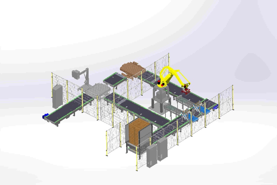

We do not work with ultra large files, up to say 700MB, the file we use as a test bed is a factory layout, see attached JPG,
This file is 450 MB, 157 files
