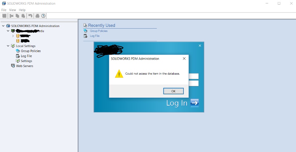

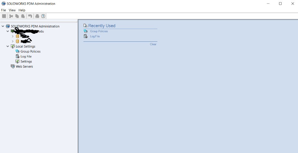

Hi, I'm working on the 2018 Student version of Solidworks PDM. We currently have one vault and today I tried to create a new one. Now, when you look at the Administration view, it shows that there are two vaults:
When I open the top one, it works fine. When I open the bottom one, I get this (after logging in using the default admin password):
When I was creating the vault, I got some error about the archive server (which I'm kicking myself for not screenshotting) and the setup decided to rollback it's actions so far. I distinctly remember seeing in the progress bar it saying "Creating database for " and then after it failed, "Deleting database for ". I then tried again so that I could better document the issue, but I got an error saying that a vault with the same name already exists where it didn't before.
I can't delete or edit the new vault in any way without getting that issue. I've tried working on it both remotely where the PDM and SQL server is installed as well as locally through the administration tool.

Hi,
1. Try to look in Registry.
2. Try to remove base directly in SQL (if it can be done).
SS
SS 2021-04-09
1. Delete Vault in Registry will not influence other Vault and should not prevent creation of new Vault (99.9%). At least in the specified places.
But some information in Registry can be implicitly.
Therefore it is desirable to keep a reserve of the deleted branches (on an emergency).
2. Too most treats SQL Server.
If there are any doubts or fears - what prevents to create Vault with other name?
By the way, except Registry there can be files of Local Views - they can disturb too. Will not prevent to clean the Temp folder yet.

Hi,
if you know the name Vault - give search (if search gives nothing - means there are no problems).
But in general watch Registry branches:
HKEY_CURRENT_USER\Software\SolidWorks\Applications\PDMWorks Enterprise\Vaults
HKEY_CURRENT_USER\Software\SolidWorks\Applications\PDMWorks Enterprise\DatabaseID
HKEY_CURRENT_USER\Software\Solidworks\Applications\PDMWorks Enterprise\ServerConfig
HKEY_LOCAL_MACHINE\SOFTWARE\SolidWorks\Applications\PDMWorks Enterprise\Databases
HKEY_LOCAL_MACHINE\SOFTWARE\SolidWorks\Applications\PDMWorks Enterprise\ArchiveServer\Vaults
HKEY_LOCAL_MACHINE\SOFTWARE\Wow6432Node\SolidWorks\Applications\PDMWorks Enterprise\Databases
HKEY_USERS\S-1-5-21-***********-**********-**********-1000\Software\SolidWorks\Applications\PDMWorks Enterprise\DatabaseID
HKEY_USERS\S-1-5-21-**********-**********-**********-1000\Software\SolidWorks\Applications\PDMWorks Enterprise\Vaults
It is desirable to check it locally and on the server. having previously (just in case) made the necessary backup copies, backups and recovery points of a system.
If there are no problems here - look bases at SQL Server.
