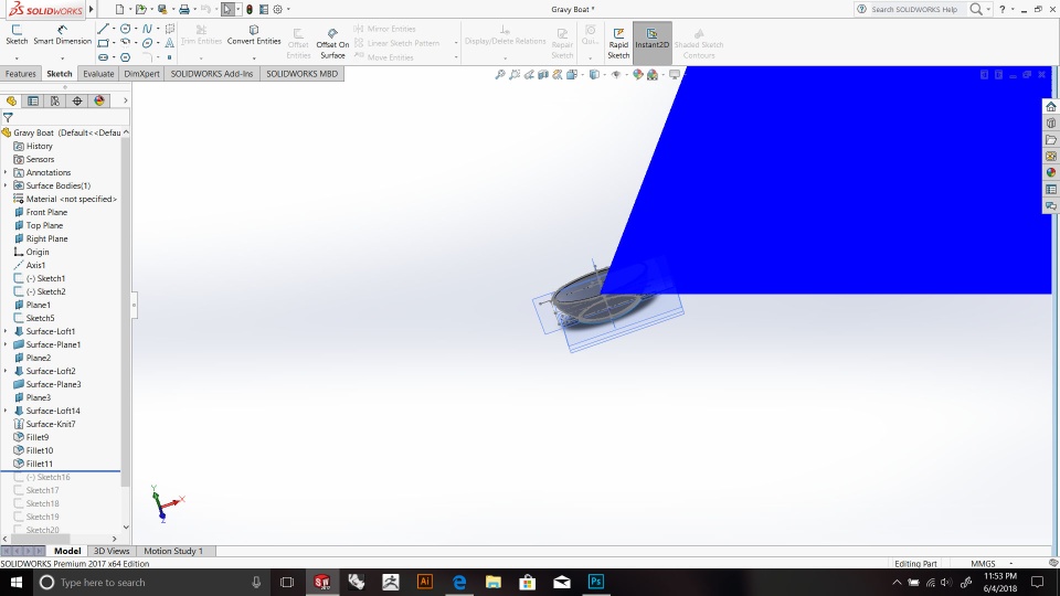

My Solidworks 2017 running on a GeForce MX150 graphics card is encountering issues with dimensioning in drawing files and part files and other performance issues.  I think things started going really bad after a windows update yesterday. I was unable to dimension in new part files and drawing files. The weird thing is that I can still dimension perfectly well on files that I've saved earlier. I have already reset all settings under tools>options. I've played around with the open GL box under tools>options>performance, it only made matters worse as performance was very slow after it's checked.
I did a system restore to before the windows 10 update and I think it only solved the slow graphics performance issue (which I later figure it's because I've checked the open GL box). I still cannot do dimensioning on new part and new drawing files. I've also noticed that things get really slow if I show the planes and this "massive blue arrow" is blocking half of the model at all times.
I've also noticed that the Front, Right, Top plane labeling no longer show up on the corner of the planes.
I've also went to the Registry Editor and renamed the Solidworks folder to Solidworks-OLD. This reset everything to when the software was installed. But it didn't seem to solve much of the problems above.
I've taken the files to another computer with Solidworks 2017 (a desktop) and it worked perfectly fine and smooth.
The software worked perfectly fine last week and the month before (when the computer is new) and now it's unusable. Hope someone here can help me.

my Windows 10 Update function often installs a "newer" graphics card driver. Therefor i make a re-install oft the downloaded driver from NVidia almost every week. Most malfunctions are gone after this procedure...

These are the two main problems that I'm dealing with right now that's crippling my ability to do things on the software.
- crashes whenever I try to do any dimensioning in a drawing file.
- dimension lines do not appear when attempting to add dimensions on part files.  Already reset to default settings.
IH
IH 2018-06-04
So I've downloaded and installed the latest driver from NVidia's website.  But still no luck with the dimensioning issues.  There are tons of things that I can set in the NVidia control panel.  I've played around with those settings and so far nothing seems to solve the problem.

You have suspicions about your graphics card, and since it is a non-supported card the VAR has no obligation to help you.  However, here is a simple thing to try.  Open SWX and with no files open go to System Options ==> Performance ==> Use software OpenGL.  If your problem goes away then it is definitely a graphics card issue and probably just a driver issue.

Unfortunately, it still doesn't work properly.  With OpenGL, it's slow to draw even the construction planes and spinning the model around is slow as well.  Without OpenGL, drawing construction plane becomes faster but spinning the model is still slow.
At this point, what is my best option that does not require me to switch to another laptop with a compatible graphics card?  I'm thinking of doing a system restore first (which I've tried already but did not solve the issue).  If that still doesn't work, then uninstalling and reinstalling Solidworks 2017 again.  If that doesn't work revert graphics card drivers several months back.  BTW can it be because of the integrated graphics card driver?  It doesn't seem to be the culprit since it did not have a recent update.
If all doesn't work, would reformatting the computer and reinstalling windows 10 and Solidworks again, and then turn off windows update sound like a good idea? The combination worked fine before, so I'm trying to set things up to that time when they worked fine.

!@$#% I've found the solution!
Solidworks smart dimension problem with lines. HELP - YouTube
CHANGE THE DIMENSION FONT TO SOMETHING OTHER THAN CENTURY GOTHIC!
WOOOWWW.....
How?!  Lost for words.  How did someone came across such solution to such problem.  And how did that became a problem in the first place...
