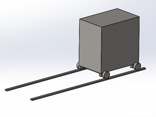

I'm try to calculate motor torque & power required to drive a cart using SW.
I have try with motion analysis tool and the result was not practical.
Following are the details of cart.
Front two wheels are drive using a single gear motor.
Wheels and rails are mild steel.
Wheel diameter-300mm
Weight of cart- 40 Ton (Approximately).
Maximum moving speed of cat 0.1m/s.(Wheel move 40 dig/s)
Within 5 minutes the cart need to reach it maximum linear speed.
The 3D model attached with motion analysis which i have done. (SW 2018)
Cart concept
Result.
Please highlight what are the mistakes i have done.
