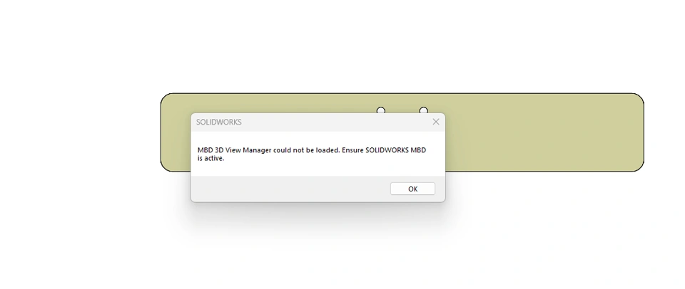

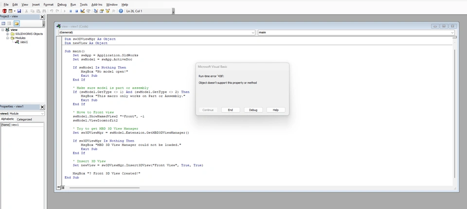

Hello, I am looking for MBD automation. While I tried using VBA and macros, I received Error 438. After verifying my SolidWorks license, I confirmed that it includes MBD. However, I encountered an issue with accessing the MBD API. I would like to know if the API requires a separate subscription or if it comes with the MBD license

Do not post images of code, paste the actual code.  Do not define SolidWorks API Interface members as Object.
Where did you get the imaginary method GetMBD3DViewManager?  Please show me the method on this page:
