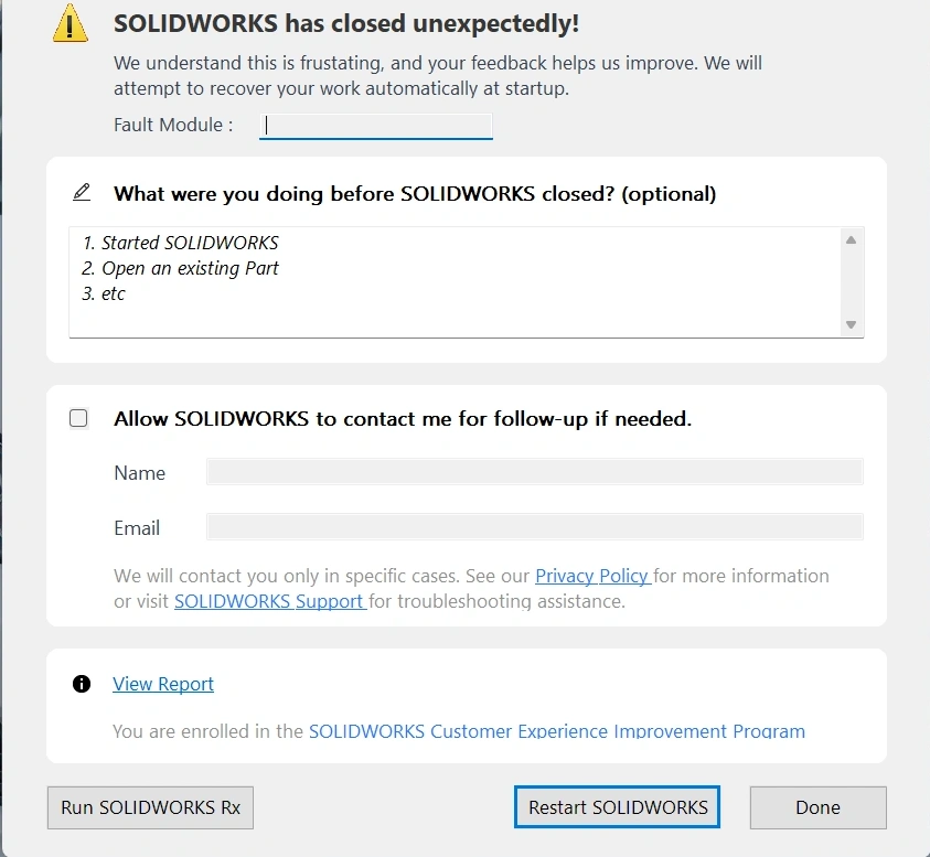

Solidworks Maker will not open, I uninstalled and reinstalled but I keep getting the same message.
Please help!!

This problem is caused by an incompatibility with Microsoft Edge WebView2 Runtime 146.0.3856.xx which Microsoft started rolling out to Windows environments on Saturday, March 13, 2026.
Hotfix -

A hotfix is available:
https://support.3ds.com/knowledge-base/?q=docid:BR10000422063
https://support.3ds.com/knowledge-base/?q=docid:QA00000445516
Try renaming the following DLL:
SWK3DCompassAddin.dll to SWK3DCompassAddin.dll.bak in C:\Program Files\Dassault Systemes\SOLIDWORKS 3DEXPERIENCE R2026x\win_b64\code\bin\SWXDesktopAddins
Hotfix -

This is a recent known issue after an update to Microsoft Edge (even if it is not your default browser).
If you use SOLIDWORKS 2026 or SOLIDWORKS 2025 SP5, Please visit the following link to access the hotfix and view instructions. You may need to sign in with your 3DExperience ID: https://support.3ds.com/knowledge-base/?q=docid:QA00000445516
If you use SOLIDWORKS 2024 to 2025 SP4, please could you try the following the resolve the issue:
1. Open File Explorer and navigate to the following folder: C:\Program Files\Dassault Systemes\SOLIDWORKS 3DEXPERIENCE [Version]\win_b64\code\bin\SWXDesktopAddins
2. In this folder, locate the file: SWK3DCompassAddin.dll
3. Rename this file to: SWK3DCompassAddin.dll.bak
4. Restart SolidWorks.
