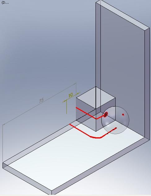

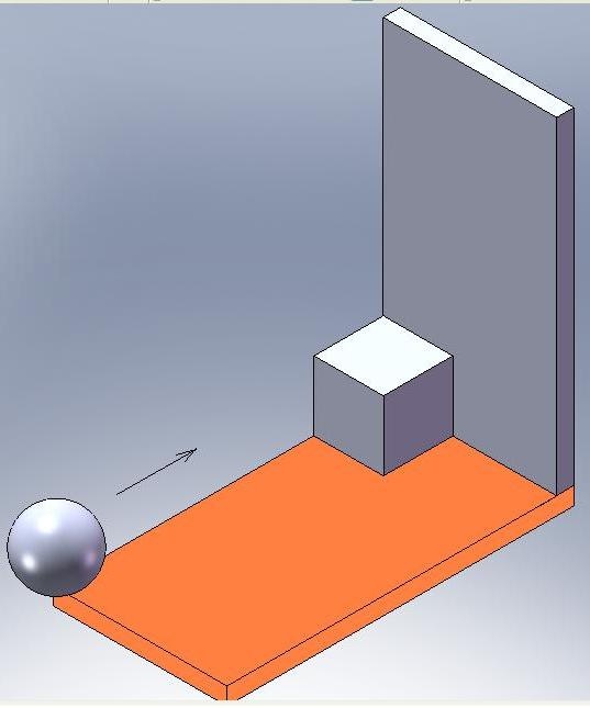

-» I have to develop a program (a macro !!!) that permitsmarking the "point" of intersection between 2 solids.
For example I have a CUBE and a SPHERE 5 units apart of each other.Starting to getting them closer i want to identify the first POINTof intersection.
Yes I want a POINT... not a VOLUME (Ei... to me, a volume of0,0001m^3 could be considered a POINT!).

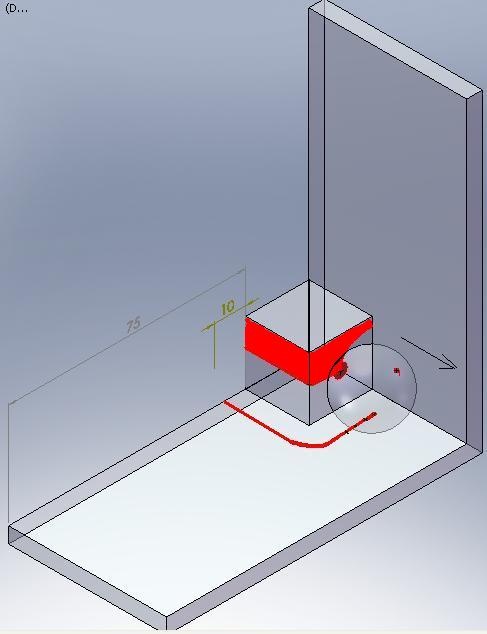

The complexity of the program rises because the SPHERE shouldcontinue to MOVE around the cube so i can get other points thatpermits drawing a line, that represents every possibilities ofintersection. Over that line the face of the cube, should bepainted with another colour.

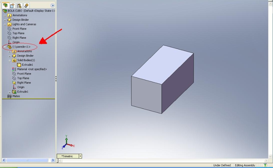

As far as I Know and could perform "hand" made... (Without macros)with a CUBE and a SPHERE (two diferents parts assembled in aAssembly type of project), i started moving the SPHERE towards theCUBE using the MOVE comand (inserting the DELTA x displacement),and started to aplly the "FIND INTERFERENCE" comand. When I got aLow Volume of interference (3m^3), I used the
Tools-> SKetch Tools-> Interference Curve. That intersectioncurve between the two solids, is a circle... and the center is thepoint I wanted to know. Next i found in the same way another pointof intersection and finaly draw the line.

Is it possible with a macro make the "SPHERE" move?
Is it possible to test the interference until a maximum VOLUME?
Is it possible to PAINT, directly in the assembly, the INTERFERENCEbetween the 2 pieces and making it a part of the assembly? (ItWould Spare the work of making lines)
