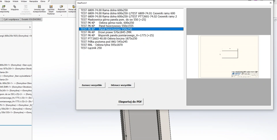

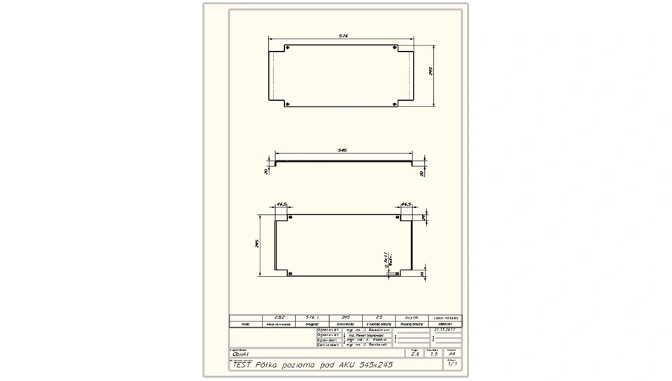

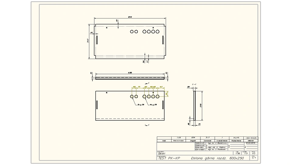

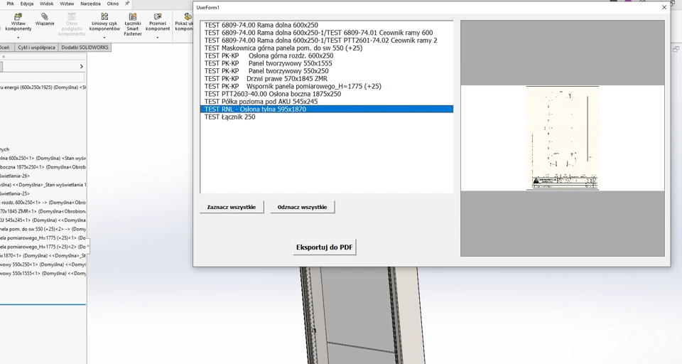

I have a problem with the bitmap generated from a 2D drawing (.slddrw) using GetPreviewBitmapFile. The image is generated with unnecessary white margins. It doesn't trim the drawing correctly. The issue occurs only with the width, while the height is trimmed properly. I use the generated bitmap to preview the drawing in the Image window in a form that I created. Below, I am attaching photos and a code snippet responsible for generating the preview.
Do you have any ideas on how to fix this?
Here are the bitmaps generated by SolidWorks (You need to click and open the image because in this view, the forum background blends with the white margins of the bitmap):
Here is the part of the code responsible for the preview:
