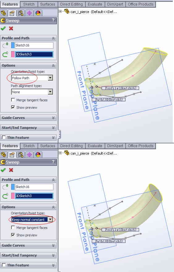

For example, if we sweep a circle or ellipse along a path without guide curve, the mathematics is simple no matter which of {Follow path, Keep normal constant} we chose.
The resultant shape would actually have a constant profile but differ only in the orientation of the profile betwee the options:
And in the these cases there is no need to consider "interpolation".

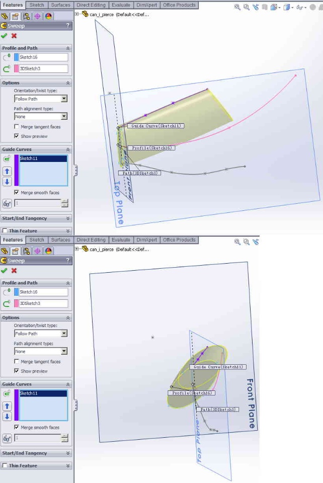

But when "guide curve" comes into play, one MUST consider how interpolation is made. If the profile is an ellipse and we have only one guide curve, it is still easy to understand how the intermediate profiles are interpolated: SW can simply scale the original profile at each point along the path to a value so that it would touch the single guide curve, as in:
And we don't see much twist here, or perhaps there is just no twist.

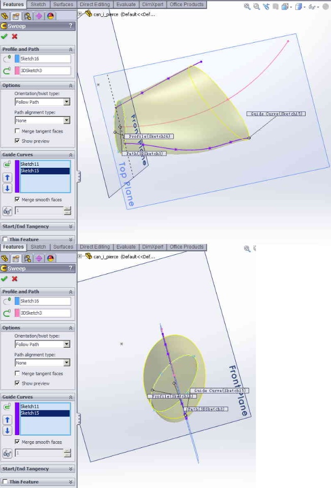

However when there are 2 guide curves, the interpolation is no longer straightforwrd, and in most cases twist is necessary in order for the profile to touch both (or even more) guide curves as well as keeping the outer surface continuous. I in fact figure that there could be more than one way to define how the interpolation algorithm would work. An example is as below:
and here we clearly see the twist of the original ellipse shape.
