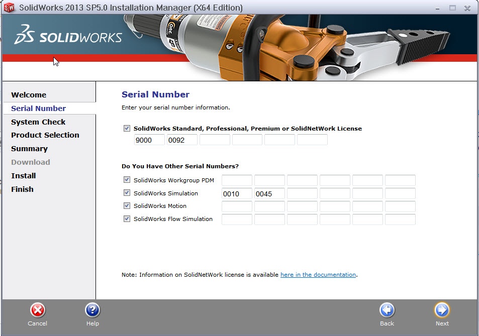

Bhange,
You can install SolidWorks Standard,Professional etc.with SolidWorks Simulation, PDM, Motion with different serial number.
Mean to say that if you have SolidWorks Standard, professional, Premium Standalone serial number and SolidWorks Simulation network license you can install it.
Arvind

My problem is to install Solidworks Professional network and Solidworks Premium standalone on the same system
One solution to install the to different operating system on two different drive but it is critical is there another way to do the same.

Bhange,
Arvind
