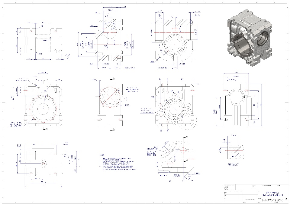

Did anyone manage to use the smart extract ?
It's always grey out and I can't find a way using it.

Hi,
Yes, I'm familiar with SOLIDWORKS INSPECTION.
I'm trying to use the new Smart Extract in INSPECTION 2018, but it's always grey out.
(Image is attached).
Is it working for you ?
Thanks!

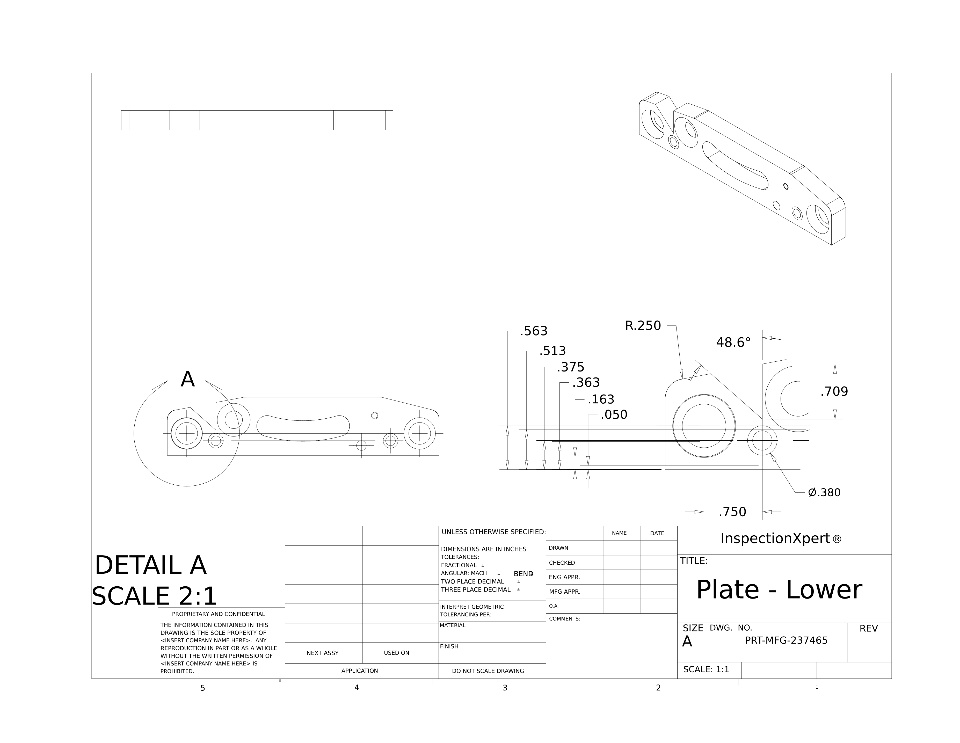

I am using searchable pdf (this pdf was saved from SW drawing).
I wonder if someone tried it and it's working.
My pdf is attached here.
Can you please test it on your machine ?
Thanks!
SF
SF 2017-07-12
I use your pdf to input Insection .
It is not working with Smart Extract.
Can you try another PDF files?
And Smart Extract is working in DWG too.

Do you have your own pdf document that it works for you ?
MF
MF 2017-07-12
Hi Akiva,
Here is an example of PDF document that supports smart extract.
Ultimately it depends on how the PDF was created but we will investigate the issue you reported.

I would like to add more information regarding this issue:
The pdf that you have attached work for me (using smart extract).
Then I guess the issue is the way SOLIDWORKS on my machine save the pdf.
Because it's a text/font issue, Maybe the fonts on my machine are not the same as on yours - that is because my regional settings are set for Israel with English and Hebrew language.
(Screen capture of the setting is attached).

I found if pdf was saved by SOLIDWORKS, it is not working with Smart Extract.
You can use SOLIDWORKS drawings and save to DWG, then use DraftSight save the DWG as PDF.
You will see it's working for that PDF in Inspection Standalone.
