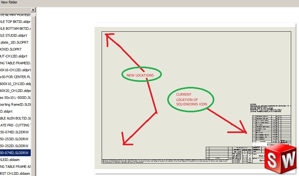

Hello all,
A Problem i am sharing with you all regarding Solidworks Drawing Preview in Windows Peview pane.
As many of us using this windows feature for quick refrence without opening the drawing .
The problem here is, many time i have to see the BOM details and TITLE BLOCK details drawing number USER ETC.But the Solidworks icon present there(shown in picture)
Many times create problem,for that  i have to open drawing and see the details.
Means if work can be done in half of a second because of the icon there it takes 1 to 2 minutes sometimes more in heavy drawings.
Please share your views on this..
Thanks
AD

BH 2013-03-01 Best Answer
Consider using SolidWorks Explorer as opposed to Windows Explorer.
Or just turn the icon off.
In windows explorer click on organise > folder and search options, go to the view tab and uncheck the display file icon on thumbnails
