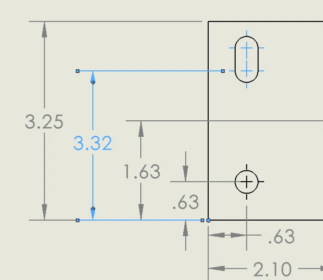

I have no clue on why this is happening. Did I make my slot incorrectly in my parts model? Everything was fully constrained in my model, and the measure tool says the highlighted portion should read 2.44" in the model view. If I try to add a dimension at the top corner, it also gives an inordinately large number in the drawing.

Fixed it. I just needed to use the vertical dimensions and horizontal dimensions instead of just relying on smart dimensions to do it for me.

Check the view property manager, and make sure projected is selected, and not the true type under dimension types. And then smart dimension will also give you the correct dimension.

Adding to Deepak's reply, "True" dimensions are only good for showing dimensions on  Isometric,3D views. They will almost always give false readings on standard 2D views.
