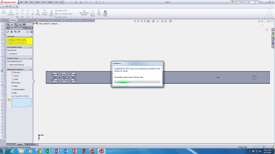

I'm a design engineer working for a manufacturing firm. Currently i'm using solidworks 2013 sp0 on windows 7 professional. I used to import customer models into the software and make changes but i'm not able to use the feature recognition option as it crashes every time i click next on the dialog box. I need a solution for this problem as we have more deadlines approaching faster in our schedule and it's hard to work on those now. I'm attaching a screenshot of how it looks. Suggestions are welcome.

Could you attach your file?

Hi Ruben,
Please see above content for the attached file.

I See it...maybe you need to fix your SW because I open it on SW2018SP3 and recognize each operation without any issue. Try to fix your SW first, and if you can't fix it talk with your VAR.
